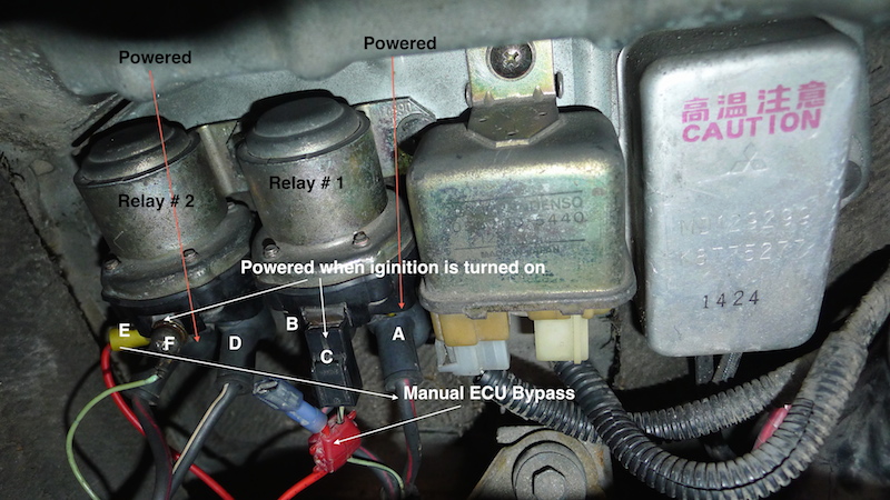

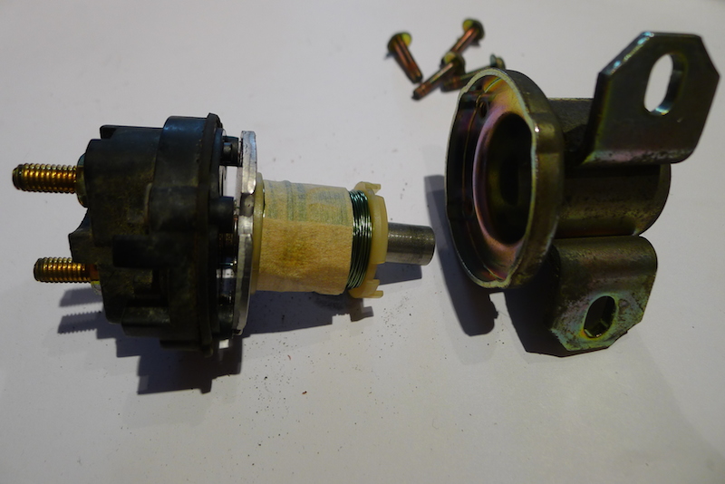

OK so the problem is back again. 1 click then nothing. No Power to the Bus Bar. Even the manual bypass does nothing.
I can get it going by applying power directly to the bus bar via a battery booster box.
So I pulled the Glow Plug Relays out, opened them up. They both looked good. Tested them. They both click and test fine.
Then I put them back in, hooked them up and Broooom, 2 clicks and it starts up no problem. That's from a cold start from the previous day.
Closed it up and then..... dead again. 1 click then nothing. This is the 2nd time I've gone thru all of this.
I'm thinking it's the 2nd Relay.
You can see in the photos. I get constant power to both relays, power to the middle line when the key is turned and a click from
Relay # 1. No click from Relay #2. I checked the starter relay and it checks out but will test again.
If it's the water temp sensor my thought is it should still allow the manual bypass to work.
The Manual Bypass has worked since it was installed.
If it's the Starter Relay would that stop the Manual Bypass?
The ECU is working and shouldn't stop the Manual Bypass.
If it's the glow plugs why is there no power going to the Bus Bar at least?
Wires are all hooked up snug to the bus bar.
So I am a bit stumped. A loose wire? It works sporadically.
I'll try to switch the relays to see how they behave.
Am I correct that "A" has power from the Battery.
When "C" receives power as the Ignition is turned then "B" sends power to the bus bar.
Same for "E,F,D". The 2nd sounding click is when the power is turned off to the glow plugs?
It doesn't appear that power is transferring to "D".
Thanks for any help out there.

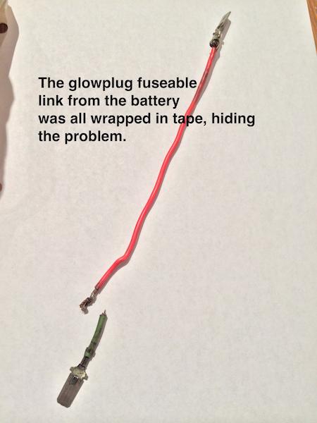

Ahh this thing is killing me! I know this topic has been talked about all over the place but I'm about to give up.
Deli still dead.1 x Click from both glow plug relays but then that's it. I'm about to give up but I don't want to incase an issue like this comes up again and I'm hours away from anywhere.

1. Problem started randomly while away from home Vancouver Island. 1 click no start, no power to busbar. Could start by jumping power to the bus bar directly from a battery booster box. Then problem fixed itself randomly. 2 clicks and start up.
2. Got home it was fine for a good dozen starts, Then no good. 1 click no power to bus bar. I opened up the glow plug relays and they both tested fine. Pulled the ECU and no leaks.Hooked it up and 2 clicks and it started, once. 2nd time and again 1 click no power to busbar.
3. Checked the batteries. Both over 12v. Pulled them and charged them up till FULL. Put them back and same as before, 1 click no power.
Tested the amps on the batts and the draw on the glow plug relays and that's where it get's funky.
Batts don't drop much of anything when key is turned over, Glow plug relays are live on 1 post each with over 12v but when they click over the power on each live post drops to zero. So tested the relays again with a seperate 12v circuit setup from my charged 12v batt box, they click and transfer power to the other post (which would send juice to bus bar).
Checked the wire from glow plug relays to busbar and they are good.
I have a manual bypass as well but I've come to conclusion that something is stopping the power being drawn from the battery when the glow plug circuit closes. e
1. Bad Batteries? 4 years old , charged up, over 12v but unable to test Cold Cranking Amps as they system isn't pulling anything.
2. Bad Inline fuse? Can't see anything bad , tested all I could find from Batteries, Is there a fuse somewhere I'm missing, and
how are the Glow Plugs gettings 12v from the batt before the click but then it drops to zero?
I'll give it 1 more try before I give up.
Any thoughts before I drown my mechanical failure with beer?

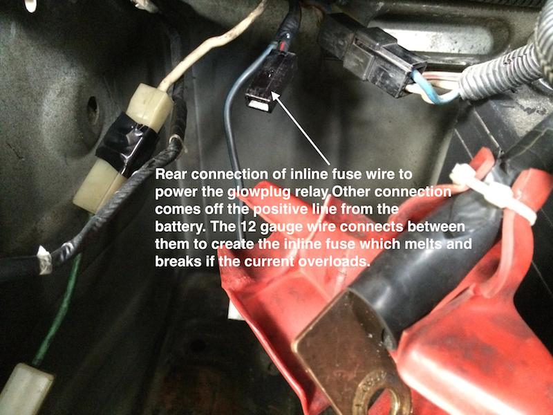

Success! Sunday sunshine brought a breakthru. Literally.
So knowing that there was 12 volts heading to the glowplug relays but it would drop to 0 volts when the relays clicked in
and knowing that if I jumped power directly to the bus bar it would start I started the search again.
Batteries volts checked out. I started again at the battery and worked forward from there.
I had checked the fuseable link already and it tested good but this time I unwrapped the whole wire and found the culprit.
Someone earlier in life had taped it up because they had done a shitty patch job on the link. Beneath the layers of tape I found a
wire held together with a few strands.
Enough to allow a little power to move thru but when the relays pulled more the wire would heat and melt apart, cooling it would connect just enough to close the circuit again.
Some new 12 gauge wire and reused connections from the old wire and she fired up first try. 2 clicks.
I unplugged the wire which caused the same symptoms , plugged it in and BINGO!
2 full days of driving and dozens of start ups no problem.
Just read the last post on the other topic of not-starting and they had almost the same find! Hurray!
Here are some photos of the culprit. Thanks to everyone and the fantastic info on this site.
Cheers.
