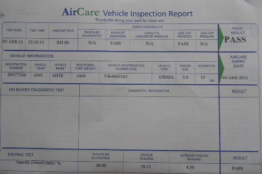

I've passed Aircare in Ontario with Blanking plates!Pajerist wrote:Did anybody pass AIRCARE with removed ECR valve?
Thanks,
- Pajerist
- Posts: 270
Re: How much do you guys smoke and what grade of diesel ? MP
Cool!Mr. Pistachio wrote:I've passed Aircare in Ontario with Blanking plates!Pajerist wrote:Did anybody pass AIRCARE with removed ECR valve?
Thanks,
I passed today too!
30 minutes of waiting (instead of 15 minutes "estimated"), no "hi/bye/please/thanks" for my $45 LOL...
My readings is THREE TIMES LESS than MAXIMUM ALLOWABLE (with removed EGR valve)
- PASS.JPG (59.19 KiB) Viewed 7474 times

Diesel tests for air care only involves the opacity level....which is basically how much soot or unburned fuel is coming out of your exhaust... What the egr valve does or means is E -exhaust G - gas R - recirculation. EGR valve is actuated by vacuum controlled by a solenoid switch only on engine deceleration. It allows some amount of exhaust gas back to the intake system to lower combustion temperatures thereby lowering emissions. Lots of times, the solenoid valve conks out or the valve itself is partially open due to soot build up. Assuming any of these conditions exists, then, loss of power (boost conditions does not exist because the valve is open) or the defective solenoid opens the EGR on acceleration ...hence, lots of unburned fuel (black smoke) and huge loss of power.
I hope this helps a bit...

As CVI has commented, usually the EGR valve gets coked up (yes that's the term for excessive soot build up, comes from the days of coal) and remains stuck open. This provides excessive exhaust gases into the intake all the time, which increase engine temps, which isn't necessarily good for a diesel. Good when the engine is cold and the extra heat warms the combustion chamber in order to increase combustibility which lowers emissions, but in the long run is not good for the engine.
And you're correct: Air Care is not looking for a decrease in NOx emissions because we 'dealt' with that demon by removing sulfur from our fuels (think about how nobody talks about acid rain any more). What the greenies fail to acknowledge is that ANY TIME something, made of carbon, is combusted (i.e. combined with oxygen), it will produce either CO or CO2. And so, Air Care is focusing on how much of that is coming out the tailpipe. I'm all for keeping emissions down, but the reality is that there is only so low the floor can go. Considering we're burning dead dinosaurs and compressed plants, well, that's all I got to say 'bout that.
