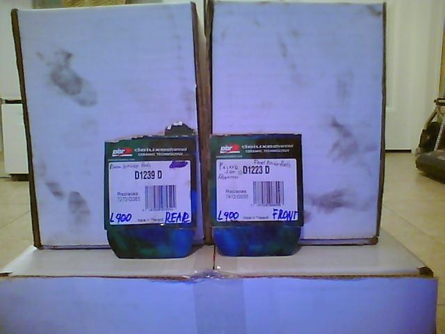

- Front and Rear Brake pads
- Picture0093.jpg (30.94 KiB) Viewed 2803 times

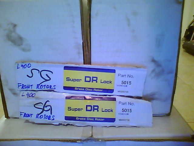

- Front Rotors
- Picture0092.jpg (34.6 KiB) Viewed 2803 times

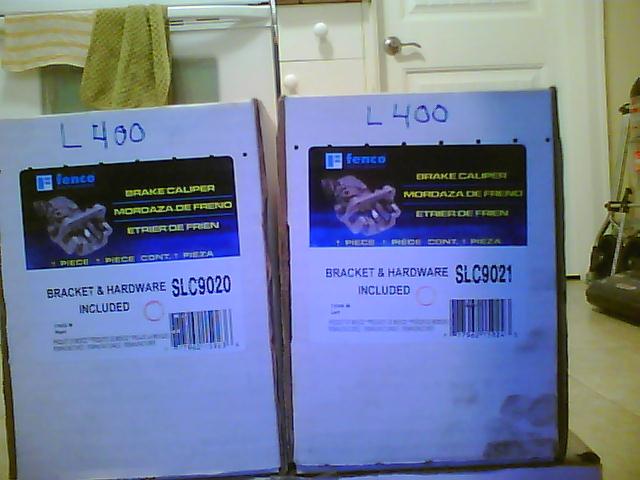

- Front Calipers Left & Right
- Picture0091.jpg (40.06 KiB) Viewed 2803 times

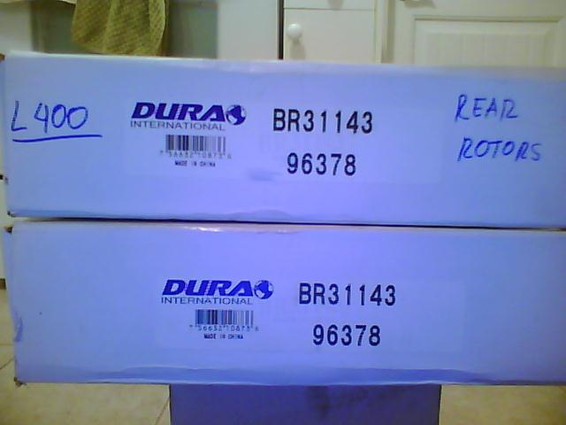

- Rear Rotors
- Picture0089.jpg (26.95 KiB) Viewed 2803 times
