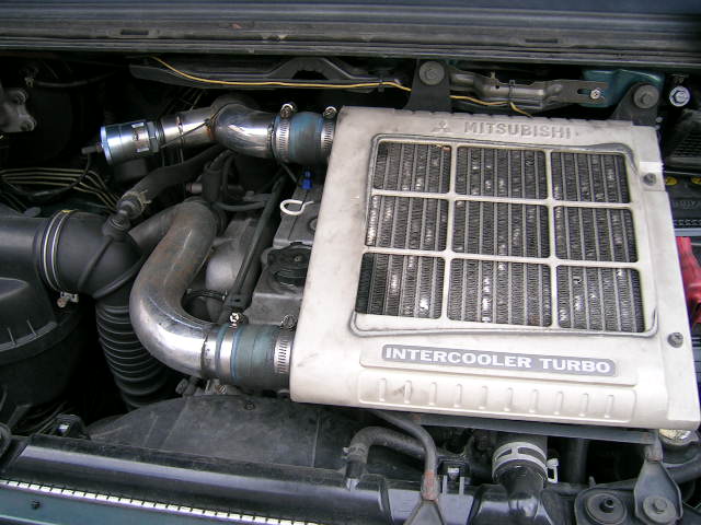

remove and replace the intercooler pipes with mandrel bent metal ones you can do in stainless
or just exhaust pipe with 3" of rubber over each end and 4 hose clamps
stops the hoses from contracting under load
or even cheaper but needs maitenence a zip tie every couple of cm apart on origonal hoses cuts down on lag get your self a unifilter $88.00 aud
i save bout 100km a tank since i got it
good luck
mick and the delig8ter
p.s. get yourself a good strong bash plate to protect your oil filter nothin worse being stuck in the middle of bum f@#k nowhere without a oil filter

metal intercooler pipes cut down on lag

i know my spacegear has this pipe attached on it.maybe i can buy this for you in japan. no problem. see attached my spacegear pictures.

mardy your pipes are great when it arrives you should get them copied (minus blow-off valve)
it goes psst when you change gears
the blow vave is designed to realease under extreme load (during realease of accelerater) to prevent the turbo fins from stopping suddenly by realeseing the back pressure created by acceleration also to prolong the life of the turbo
however unless your driving like a maniac all the time not really nescersary (personal opinion )
i hope i didn't balls up this explanation
if ya want to see how much the standard pipes contract while acelerating get some one else to sit in drivers seat and rev (watch em move )
hope this helps

since I'm a plumber I made up some out of copper tubing and fittings.....I'll post pics if I can.... what a difference it made.... pulls way better on the highway when passing....
