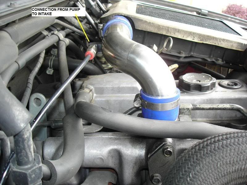

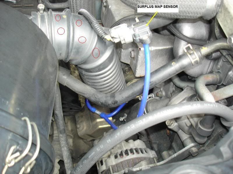

All right here are the photos how we installed the injection system:
